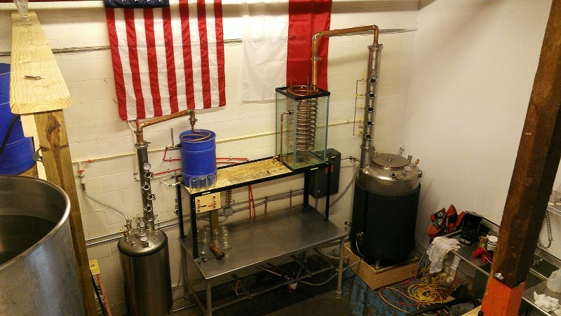

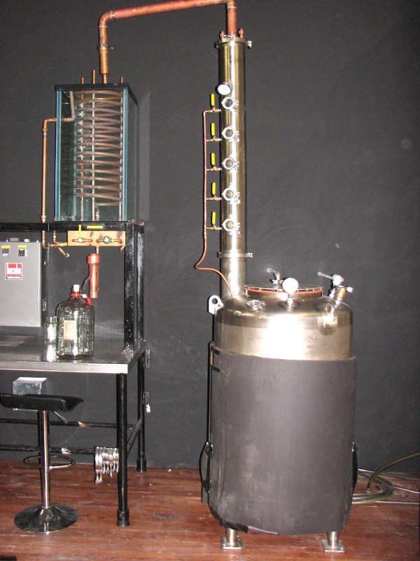

The Stills
There are two stills, one smaller, one larger. Both are similar in that both the boiler and columns are stainless. The only copper in the systems are the lyne arms (that transport the vapor to the condensers) and the spiral, old time "worm" in tub condensers. Both have a copper "parrot" to test alcohol percentage at the end.
Both have five levels or "plates" on the way up the column. Each level is progressively cooler than the one below. Each plate is perforated, each perforation covered loosely by a cap of sorts. All you need to know is that some of the vapor condenses on the plates at each level, and drips down onto the plate below. In the case of the lowest plate, it drips back into the main boiler. Thus the vapor is repeatedly recycled and refined, to the point that only the highest percent alcohol finally exits and is carried to the condenser.
Typically a set up like this can produce spirit at 90-95%, probably closer to 90% (much thinner and less tasty than a pot still, whose output is a rich 60% or so). The output can be controlled via temperature, speed and also by recyling distillate at various levels directly back into the boiler (see yellow valve handles on lower picture).

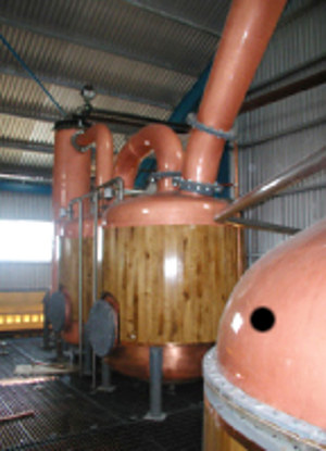

The Carolina rum you like is a single column distilled to at least 90% in a single run. The Worthy Park is an absolutely classic pot-still with thumpers, distilled to about 60 or 65%. Both use a single run.
Worthy Park produces both light and heavy pot rums, but both will contain considerably more esters (say 300) than the column setup (say 50). Furthermore, you can be sure the Worthy ferment is longer for even more diversity than even a good light, column-stilled rum.
